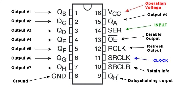

To connect the 74HC595 chip, consider the Pin Datasheet below. The necessary pins for the shift register to work is wire up the GND and VCC for power (it works for both 3.3V and 5V). SER is the serial input pin, where set the bits of data along with the shift register clock (SRCLK). When setting all 8 bits, you enable the Latch pin (SRCLK) to copy all the 8 bit values to the latch register. In this post, wire up the Output Enable (OE) pin to see the output changes for when the bit values are latched to the shift register. This pin is an active low, so it needs to be connected to ground. For more information, you can find the data sheet here.

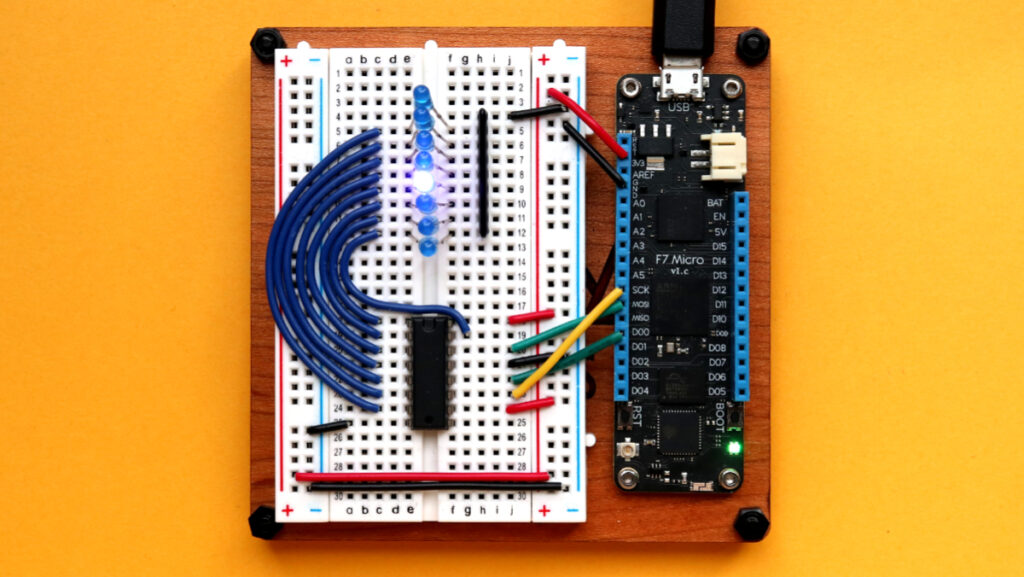

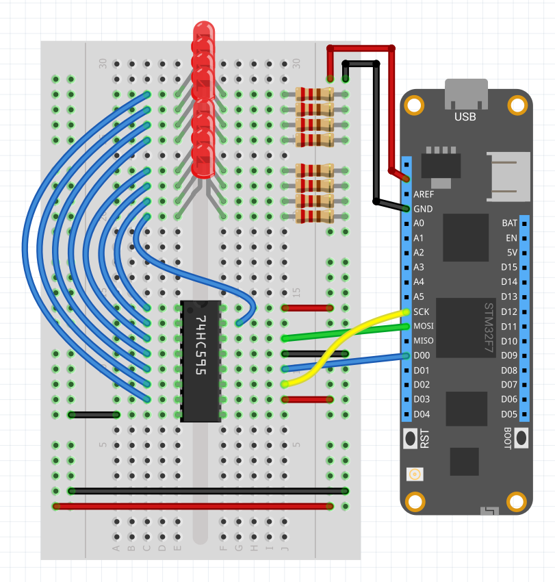

Now that you’ve gone through the pinout on the 74HC595, build the circuit on a breadboard along with your Meadow. Follow the diagram below, and make sure you’re connecting everything exactly as illustrated. To illustrate that output ports are working, wire an LED for each port with the GND leg connected to a 220ohm resistor like below:
