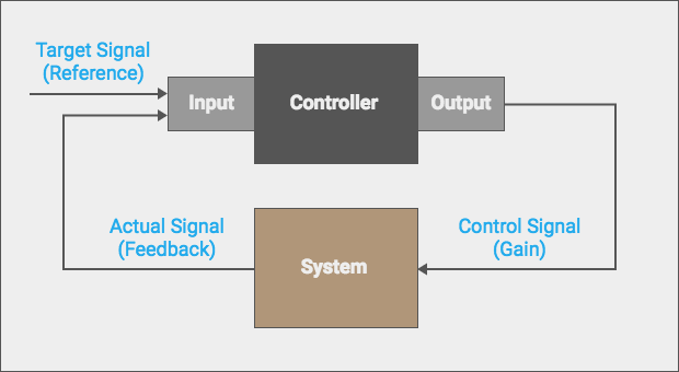

PID uses a closed loop gain controller, so-called because the control output is fed back into the system and the controller is then given the response to its previous control signal and can react appropriately to the change and further refine the output:
This concept of encapsulating functionality into some sort of logical container such as a class is not uncommon in programming, but in hardware, controllers are used everywhere, and these feedback loops are often an integral part of them. We’ll examine the use of controllers as a pattern when we look at the code that powers the dehydrator app.
